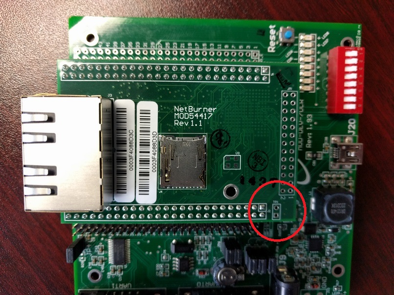

Re: Did you 'brick' your MOD5441X or NANO54415? Look here...
Adding MOD54417 jumper location image
- MOD54417-Jumper2.jpg (212.38 KiB) Viewed 24874 times
