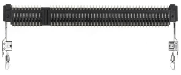

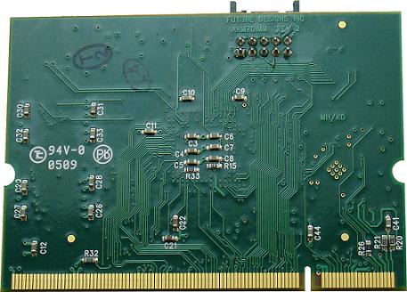

I would make the board as shown below for the 200 pin SODIMM socket.
Also shown below is the socket for it. With a cost $2.24 in multiples of 25 from digi-key (A97498CT-ND).
Sure it may be more than dual row 50 pin 0.1" headers. however, 0.1" headers are through hole parts and cost more to have stuffed at a board house. With a connector of this style and high pin count its a pita to insert and remove. With having many surface mount parts on my main board i cringe when i insert the MOD boards as i feat one day the force it takes to insert it will flex the board in a way to loosen or even crack a SM part near the connector.
Board Style
Board Style
Connector
Connector
