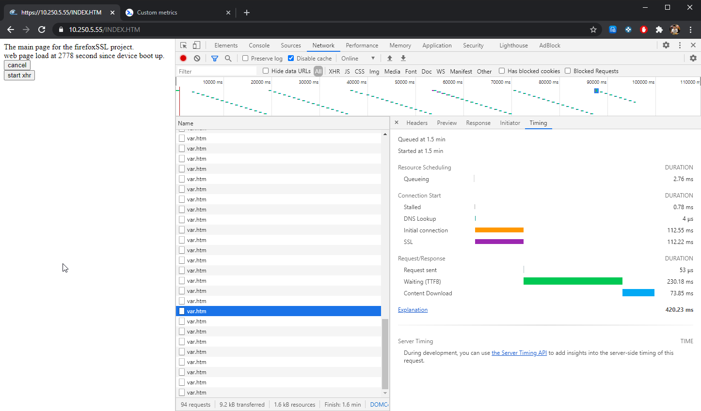

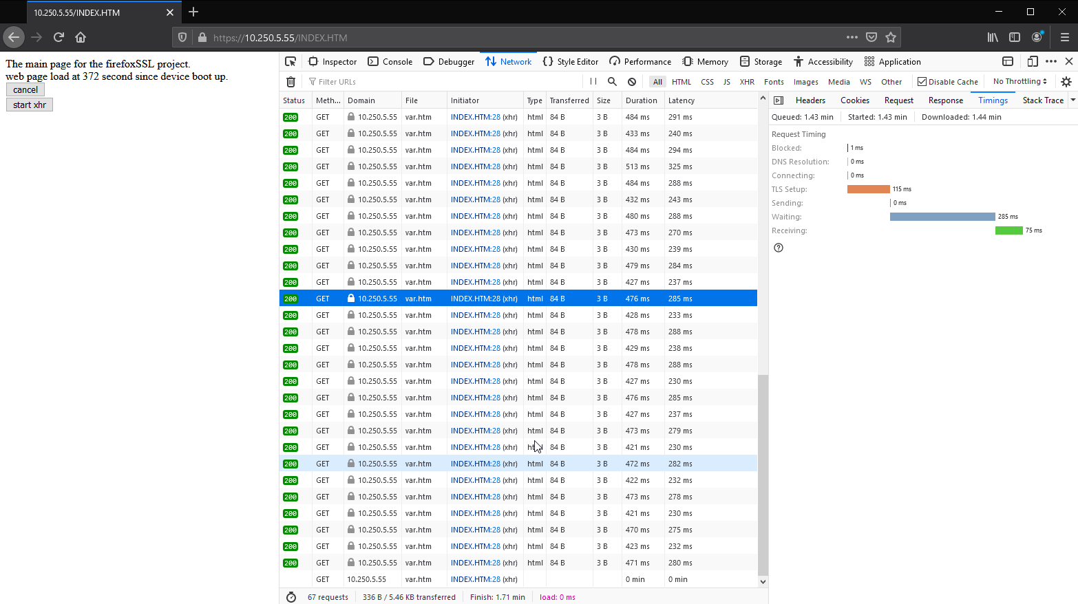

I agree UserMain having the lowest priority. But each XHR request will take about 500ms to complete both in firefox and chrome. I can see the SSL/TLS connection negotiation time is about 100ms in the FireFox developer tools panel. Also the XHR request will abort if it's not complete before the next request.
FireFox

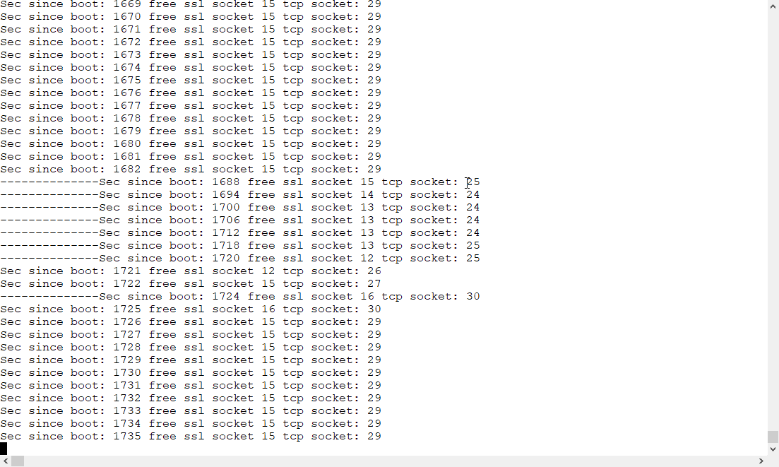

The ssl and tcp are have enough socket available to use, even during the delay.

Even though the web server have the higher priority over the UserMain to run, during those delay xhr request can't establish a connection with server. what could possible stop the server from working with more than enough socket available to use
