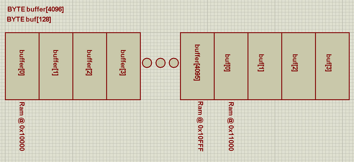

I am having a hell of a time getting my thoughts properly in text. I made this drawing to help with my confusion.
From what everyone is saying is that when i declare buffer[4096] it basically creates a pointer to where that data starts at.
yet it keeps no knowledge of how long that data should be even though i said it was an array of 4096 bytes. So how then would it know where to put another new variable buf[128]? without overwriting the area for the first one.
Re: Confusion with calculation of ram usage
When you write the following code within a function:
Buffer[4096];
Buf[128];
you are defining arrays without an explicit initialization, with no linkage, and as two variables w/ automatic storage duration. Objects with automatic storage have an undetermined initial value unless they include an initializer. This means that although space for the array gets allocated out of the task's stack, (first Buffer, then Buf, just as you drew) no data is written to either array yet. Data only gets written into individual elements of an array by explicit calls from within the function. Because space is allocated, (even though not written) the address of Buf is correct with respect to Bufffer. Now, lets say Buf exceeds the task's stack space by one byte. Merely defining Buf causes no issue. However, if you try to store data in Buf's last byte, the stack would overflow and which MIGHT cause an issue by overwriting either an adjoining task's stack space, the ISR RAM, or a heap-allocated buffer. I don't think compcode will catch automatic variables defined inside a function...
When you write the same code outside a function, the array has static storage duration and it's implicitly initialized with the default value of 0. Because these vars are not part of a function that runs as a task, I don't think they're allocated from a particular stack's space, but from the heap. I think compcode will catch these definitions if they exceed the RAM allocated for heap: ".bss will not fit in region ram" or "region ram overflowed by xxx bytes"

Ridgeglider wrote:from the heap
Nope, not from the heap; static allocation does come from .bss, but that is not the heap.
