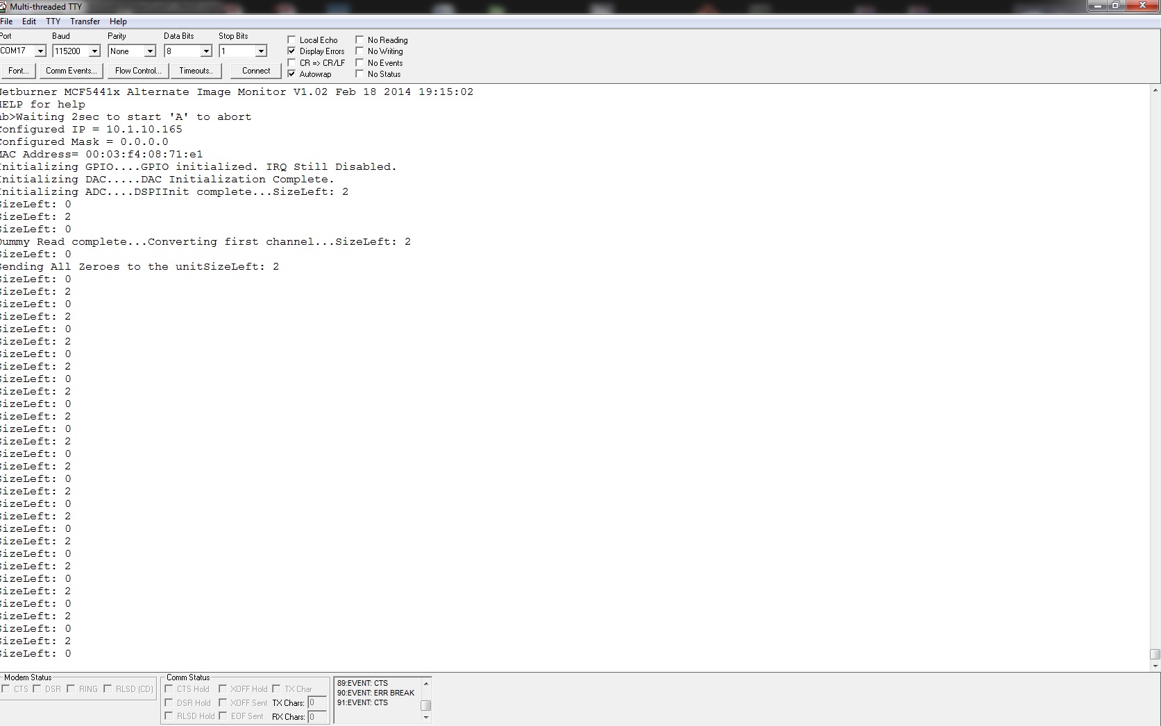

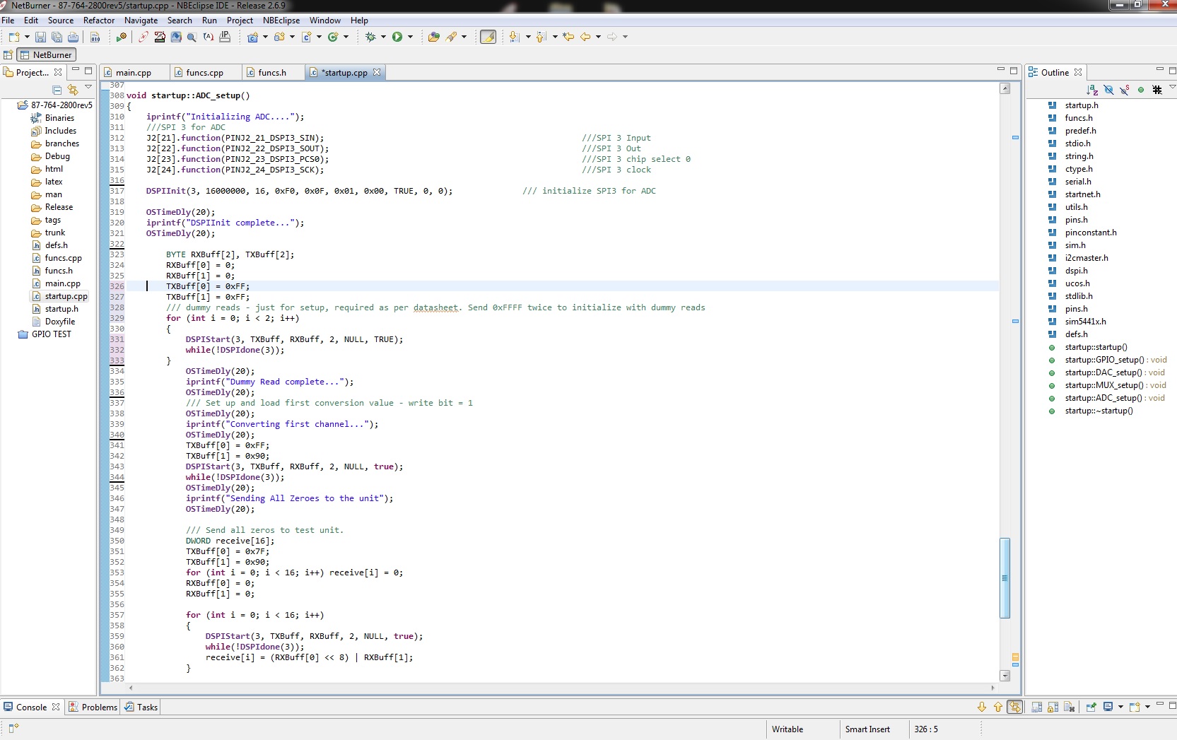

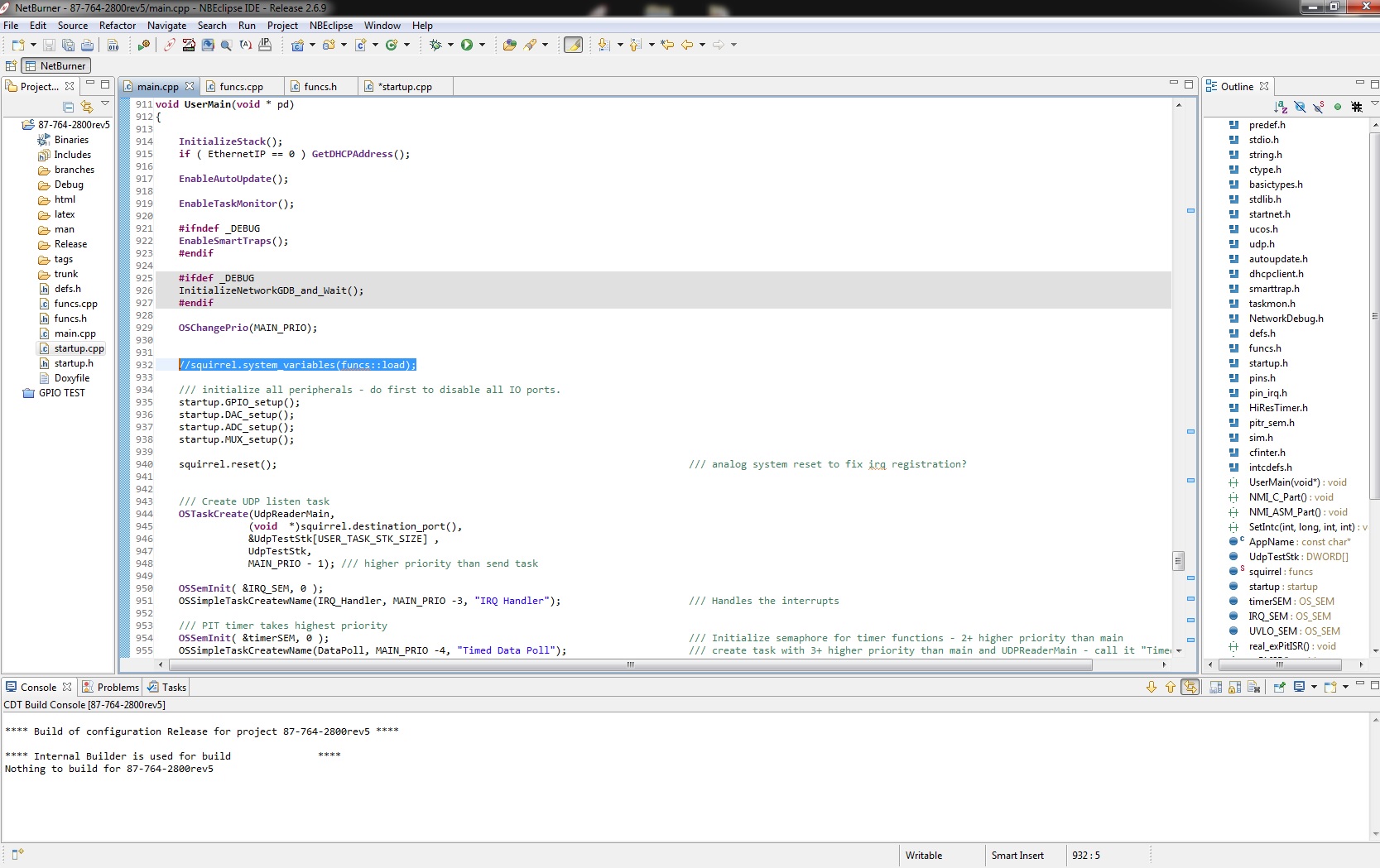

I loaded my firmware into a unit, and had a few bugs but I can't figure out one of them. When my unit loads, it initializes the GPIO being used as just IO, Then a DAC, which loads fine, then a SPI controlled ADC. This worked perfectly in my last version of my software so I never touched the code, but right after my DSPIInit function, as it begins to send a dummy read command to the ADC (mfgr spec) the task monitor (I believe) splashes the screen with "SizeLeft: 0" or "SizeLeft: 2" - not sure what this means - Screenshot attached. I should note that I originally had code that loaded values from user flash prior to loading the peripherals. I have since removed this line of code. I also attached a few screenshots of the code, sorry, not allowed to show any more of it... And sorry if it's squashed a little, had to cut out a few comments to get it all on the page.
So, can someone enlighten me on this? Thanks for all the help!!!
This is the init function for the ADC.
Section of User_Main() that calls the class functions and shows the commented out load function for the user flash area.
MTTTY output
MTTTY output

It is unlikely that the "SizeLeft" output is coming from TaskMonitor; that code is only invoked by the TaskScan utility when you run it from the NBEclipse IDE.
It is more likely that there is a printf() statement somewhere in your code that is outputting "SizeLeft". You should do a file search for that statement.
I see that you are running NBEclipse Release 2.6.9 which was unstable and pulled by the NB development team. As a first step, I would try rolling back to 2.6.8 or 2.6.7 .If it works in those releases then you might try 2.7.0, although that is a beta release.

I'm don't fully understand TaskScan enough to understand how to interpret what I see. I can tell you this though, this is occurring in one of my startup functions. This function hasn't changed since Rev3 of my software and has always worked. I only just recently added iprintf statements when I noticed that my system was locking up at startup. I sometimes do that in lieu of running the debugger so that I don't have to disable any of my timers or the cwt (Still learning a bit...). None the less, my iprintf statements end before the main while loop. None of my iprintf statements are outputting "SizeLeft". This output is occurring in a loop that has no iprintf statement. It is the 16 count loop under the "ADC_Setup()" function.
This is the loop:
			for (int i = 0; i < 16; i++)
				DSPIStart(3, TXBuff, RXBuff, 2, NULL, true);
				while(!DSPIdone(3));
				receive[i] = ((RXBuff[0] << 8) | RXBuff[1]);
Also, I did not run the debugger if that's what you're referring to. I'll try loading it through "AutoUpdate" to see if that makes a difference.
