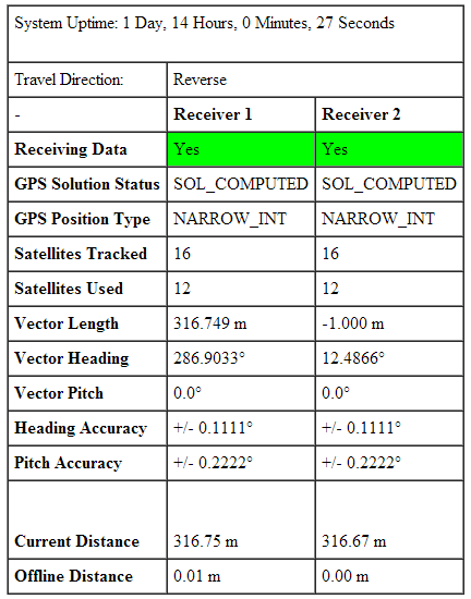

I see the HTTP task is the one that was running at the time. I have a web browser displaying a page from this device with an AJAX section that pulls data every 1 second, so I expect the HTTP task to be doing stuff.
So how do I figure out what is causing this random problem?

As this appears to be related to STD, I went through the code that AJAX function calls to find all instances of STD to see if I could remove them. I had 12 places with code like this:
siprintf(output, "%s", std::string(str_SomeVar).c_str());
but I discovered the std::string part is not necessary to convert a string to a c_str for use in a siprintf. Ended up changing them all to:
siprintf(output, "%s", str_SomeVar.c_str());
Hopefully this completely eliminates the issue, although if it does, I'm still going to be curious what was causing this trap. As of right now, the system has been up for 10 hours, so I need to wait a couple more days to see if it does anything odd.

Here is the code from my web.cpp file as it is currently. Since the active task at the time of the crash was the HTTP task, I think the issue is/was in this file. The web page with the AJAX call was running the getAJAXSystemStatus function with a 1 second refresh.

That call creates a table that looks like the image below. As you can see, current up time is 38 hours, no traps since I removed the std::string() stuff.
