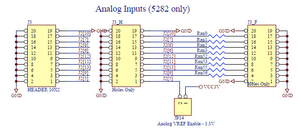

The Dev 100 R12 schematic suggests there might be a resistor connected to j2[6] for use w/ the AD inputs on the 5282s... It looks like it's not usually connected, but don't have a board here to inspect.

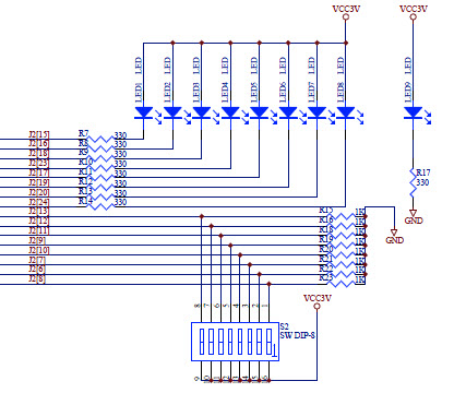

The Dev70 boards have a 1K pulldown to ground associated with the Dipswitches.
- Dev70.jpg (66.09 KiB) Viewed 11959 times
- J2-6 with resistor.jpg (69.62 KiB) Viewed 11959 times
Re: Bit banging one wire protocol - help needed
Bingo. I'm on a dev70 board, and it never occurred to me to even look at the dip switches. And there's the 1k pulldown. Mystery solved.Ridgeglider wrote: The Dev70 boards have a 1K pulldown to ground associated with the Dipswitches.
