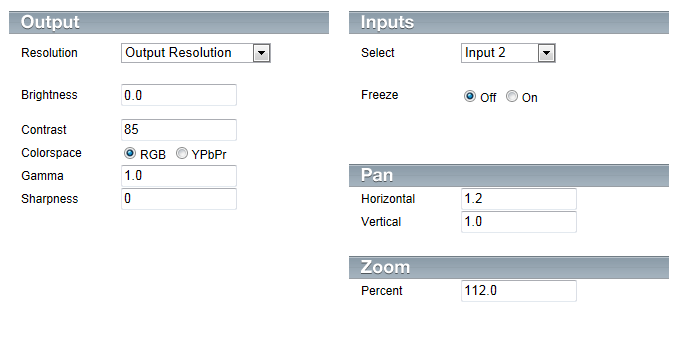

Here's a screen shot that my illustrate it better. I want to update the value in these fields on the webform if they are changed in the background by another user on a different laptop or at the device itself.
So if two people are connected to the webpage for the netburner and one person makes a change the form will update with the current values in the form on the other laptop.
The issue is finding what the correct javascript is to update the form elements.
See the attached screen shot.
- NB page.png (15.48 KiB) Viewed 13468 times
