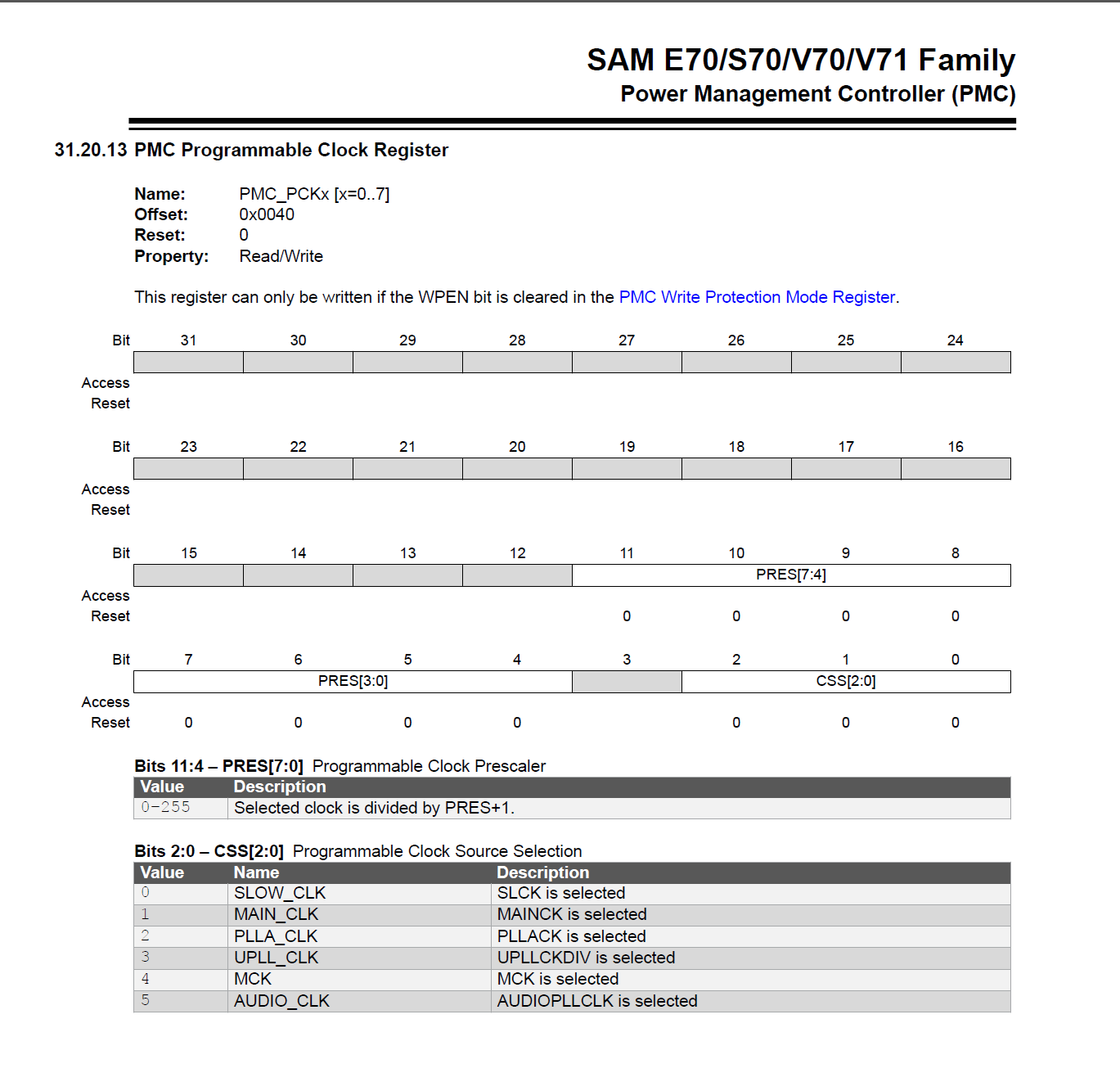

Just doing a quick search I found the following table in the same section you referenced. So you can set the programmable clock to MCK. Also, each can be set independently (sorry about the formatting).
So I think this answers the "could" question.
31.12 Programmable Clock Output Controller
The PMC controls three signals to be output on the external pins PCKx. Each signal can be independently
programmed via the Programmable Clock registers (PMC_PCKx).
PCKx can be independently selected between SLCK, MAINCK, PLLACK, UPLLCKDIV and MCK by configuring
PMC_PCKx.CSS. Each output signal can also be divided by 1 to 256 by configuring PMC_PCKx.PRES.
Each output signal can be enabled and disabled by writing a ‘1’ to the corresponding bits PMC_SCER.PCKx and
PMC_SCDR.PCKx, respectively. The status of the active programmable output clocks is given in PMC_SCSR.PCKx.
The status flag PMC_SR.PCKRDYx indicates that PCKx is actually what has been programmed in registers
PMC_PCKx.
As the Programmable Clock Controller does not manage with glitch prevention when switching clocks, it is strongly
recommended to disable PCKx before any configuration change and to re-enable it after the change is performed.

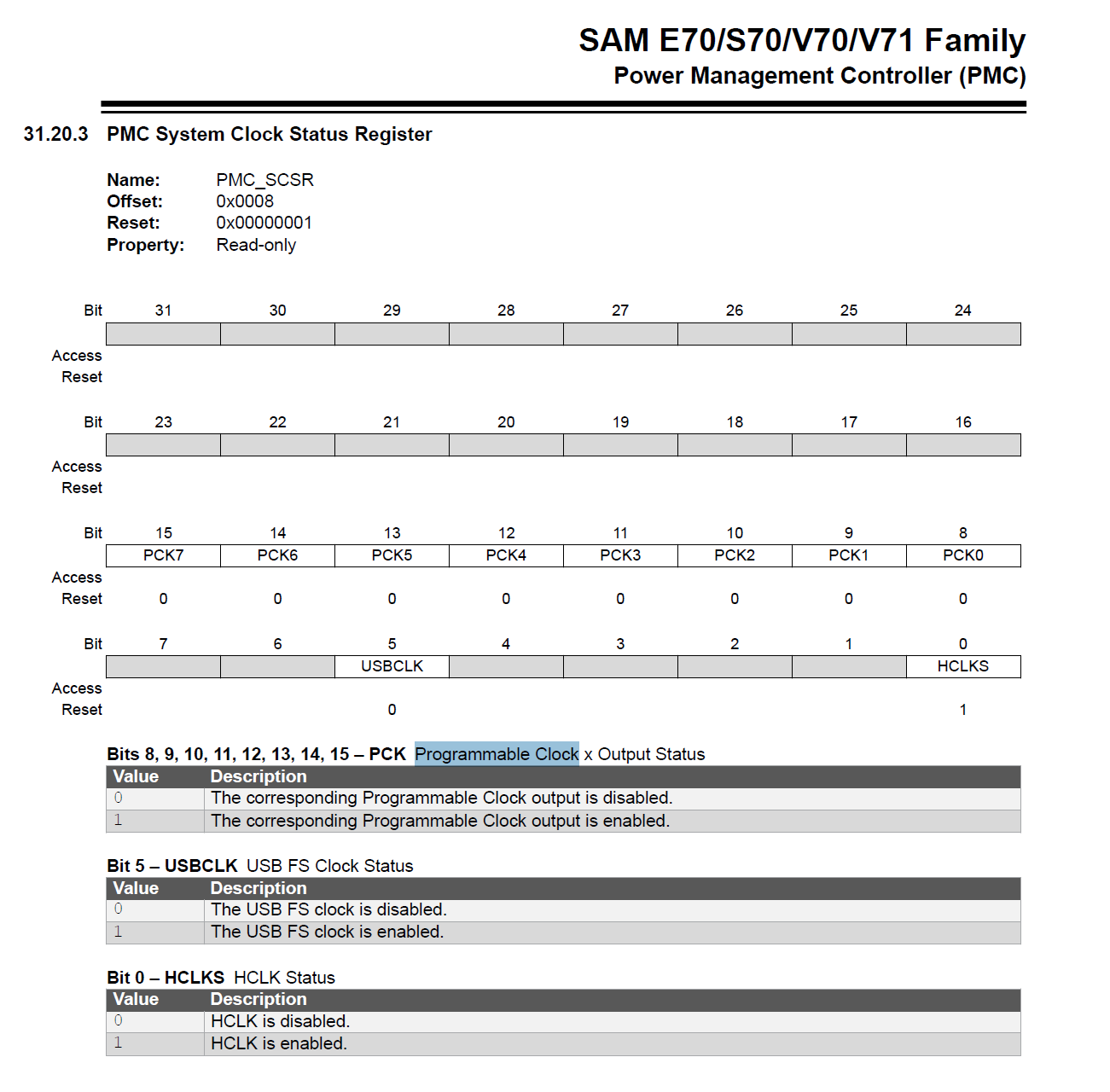

So if you enable it to be the programmable clock output it will output whatever you set PCKx to.
*** I would first read the status register to ensure it was not being used, which it should not be. Screen shot attached as well.
Is the issue that you are having a problem reading/writing registers? There are so many peripherals and registers on this part; we do our best to cover the most common ones first.
