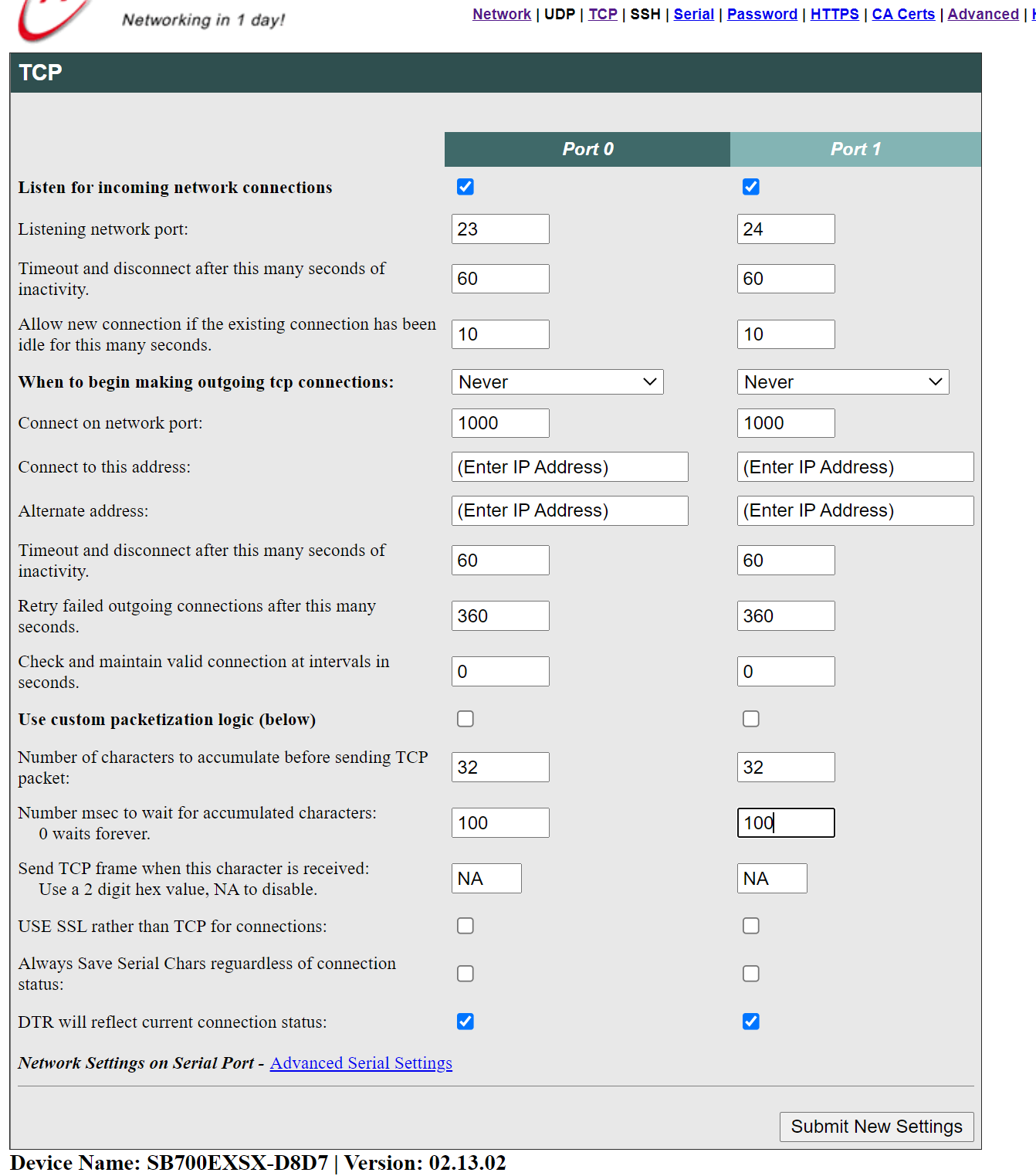

Attachment shows the TCP Packet settings.
- TCP_Settings.PNG (172.73 KiB) Viewed 37934 times

Thank you for the additional information. From my previous post, the biggest area of concern is the virtual comm port driver and software applications that rely on it for this test, such as teraterm. If you do not use a virtual comm port driver at all, and instead use native telnet to talk to the device, do you see a delay? You should be able to copy/paste files if you need to, but also just type and see if there is a delay. Nothing should be buffering/delaying for minutes at a time, and I'm not seeing that behavior here.

Another question: how large is the file you are sending, and what baud rate are you running at? The TCP stacks on both the PC and NetBurner device will buffer thinks on the network side if the serial buffers fill up. The network is running at 100Mbps, so it is significantly faster than a serial port, and the network side will use flow control.
