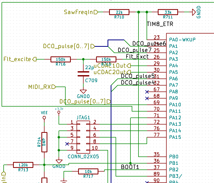

·as the board is mostly unpopulated yet, there is nothing attached to any of the pins of GPIOA, except the JTAG, which shares some of them.

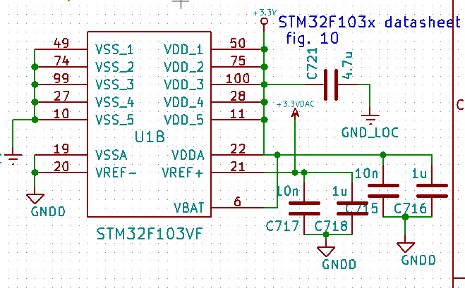

·the Vref+ -pin on the MCU is unconnected except for the decoupling caps, as there is a external reference which is not yet soldered on the board. As I was just testing, I was under the impression that VCC would be used for Vref+ in this case (although I realize now this is probably not the case). Could this actually cause destruction of the part?

Fig 1: GPIOA. All the labeled connections go to unpopulated areas of the board.
Fig 2: Power. 3.3VDAC is currently unconnected, but the caps are populated.
